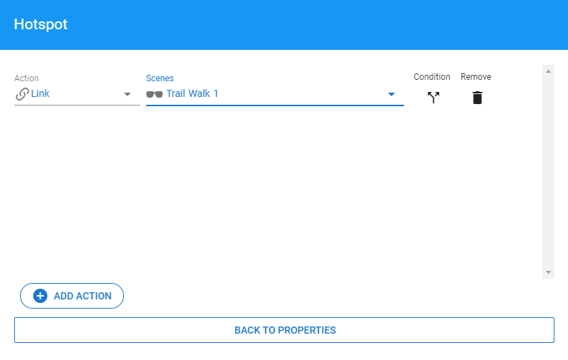

  1. Link to Scene allows you to move from one scene to another. Simply add a Link to Scene action to a hotspot, question choice, or as a timed action. Then choose the location in which you want to move to.

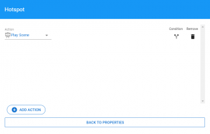

  2. Play Scene lets you play a video-based scenario. By default, the video will play once added unless you deselect the Loop option.

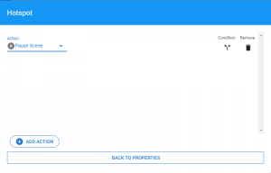

  3. Pause Scene lets you pause a video based scenario. This may be helpful if you want to discuss what previously happened using audio or an info card, or test their knowledge progression using a question card.

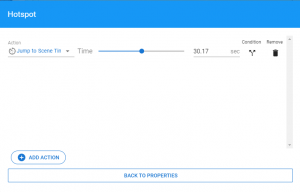

  4. Jump to Scene Time lets you choose a specific time in your video-based scene you wish to skip to. This is helpful if you want to move forward in a scene when the person has successfully completed an interaction.

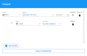

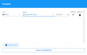

  5. Show gives you the ability to show an object. Add a Show action to a hotspot, question choice, or as a timed action then select the object you want to show. You can also select the duration in which you want to the object to show.

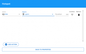

  6. Hide gives you the ability to no longer show an object. Add a Hide action to a hotspot, question choice, or as a timed action then select the object you want to hide. You can also select the duration in which you want to the object to hide.

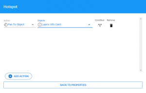

  9. Pan To gives you the ability to move your scenario to a particular location based on where an object is on the canvas. Add a Pan To action to a hotspot, question choice, or as a timed action. Then choose the object in which you want to pan to.

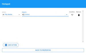

  13. Play lets you play audio, video and/or timer objects that exist in the scene.

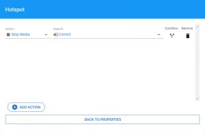

  15. Stop will stop any audio, audio, video and/or timer objects that are currently playing in the scene. This will reset the video back to the beginning if played again.

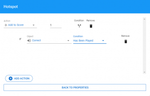

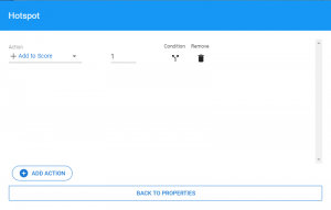

  18. Add to Score disables automatic scoring and allows you to use the Score value for your own counting purpose. You can also subtract from the score by entering in a negative value.

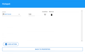

  19. Set Score overrides the automatic scoring and marks it to the value in which you specified.

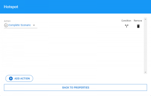

  20. Send Completion will report to the Learning Management System (in a SCORM publish) that the viewer has completed the scenario. This will pass “completed” to the LMS along with the viewer’s score (if any).

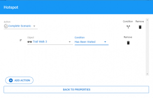

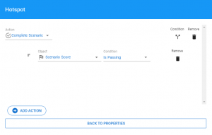

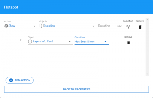

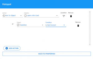

Conditions
Actions can also include a Condition. This allows for decision-based development.  When adding a Condition, you’re essentially stating that only if this is or is not true will something be performed on the screen or behind the scenes.  You can base conditional actions on a variety of objects like hotspots, questions, scenes, audio, video, images, info cards, and the scenario score. Depending on what you select, different things can be happen.

Questions
  • Is Correct
  • Is not correct

Audio & Video
  • Has been played
  • Has not been played

Images and Info Cards
  • Has been shown
  • Has not been shown
Scenario Score
  • Is Passing
  • Is Not Passing
